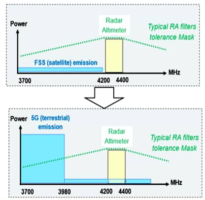

I have been discussing this today with friends at work who are in spectrum management.
I think the problem is largely with filters on these aeroplanes.
Upgrading filters on aeroplanes may not be viable for airlines especially when revenues have gone down massively due to Covid.
And add more reasons for the pilot safety announcement asking passengers to switch off phones :smile:
But agree, this will be the practical step.
To replace filter.
Will the interference still there, although lesser for countries with lower 5G midband, i.e. 3.4-3.6 GHz?
Yes, correct.

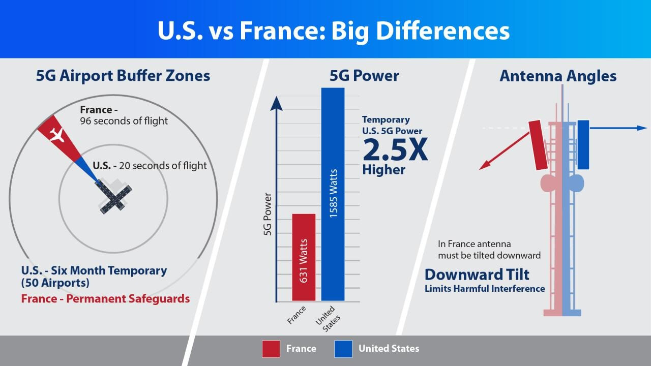

From Mathworks:
I wonder how they got to this “5G power” values…
