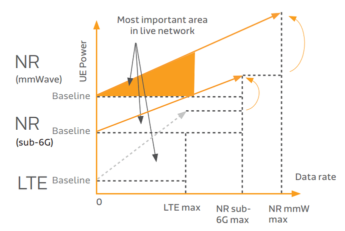

This is Mediatek evaluation about UE power consumption.
Baseline is power when UE in connected mode with no data transfered.
Baseline power consumption of NR mmwave >> NR sub6 >> LTE.
5G’s Power Problem:
