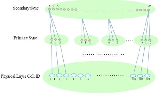

This can help:
Depends how deep you want to look.
Each primary and secondary sync signal is a sequence, these are orthogonal and with certain length you can create only certain number of orthogonal sequences.
Primary are only 3, because UE has to scan for these on all possible frequencies which is time demanding if you would have many, once sync signal location is found by PSS the SSS can have way more sequences to run correlation to.
There is a relationship between length of sync signal and probability of successful decoding in particular SNR.
So as always an engineer trade off :slight_smile: these decisions are documented in 3GPP papers.

PCI is made from two signals- PSS and SSS.
  • PSS has just 3 options (0,1,2). When a phone turns on, it has to search for PSS across all frequencies to find a cell- this needs to be fast. Fewer options = quicker search.
  • SSS has 168 options. Once the phone finds the cell using PSS, it then reads SSS - at this point speed isn’t as critical, so more options are allowed here.
So total combinations = 3 × 168 = 504.
It’s not a random number - engineers designed it this way to balance two things: making the phone’s initial cell search fast, and still having enough unique cell IDs. That’s why LTE ended up with exactly 504 PCIs.
