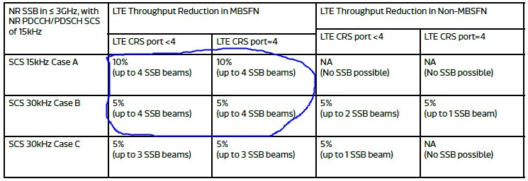

Why there is less degradation in LTE throughput when we use SCS30 for SSB compared to SCS 15 KHz?
Because when we use MBSFN subframe for SSB, that whole subframe is not available for LTE PDSCH. So how does it matter what SCS we use for NR SSB?

Which Hedex is this table from? I cannot find it in 3.0 or 3.1…
It’s not from Hedex… It’s from Mediatek paper: Dynamic Spectrum Sharing (DSS) - MediaTek - Mar 2020
Assuming 4 SSB beams, you need double the MBSFN subframes in case A compared to case B and hence double the reduction in LTE throughput
For case of 1 or 2 beams, case A should be 5% as well
The reason of case B better than case A is definitely due to SCS 30 KHz itself has better throughput than SCS 15khz, considering for DSS SCS30 KHz has penalty due to guard band being there tackling asynchronous with LTE.
NR SCS 30 KHz numerology should be throughput beneficial since its half time slot, short latency for efficient traffic scheduling, and NR’s gain over LTE is enlarged.
