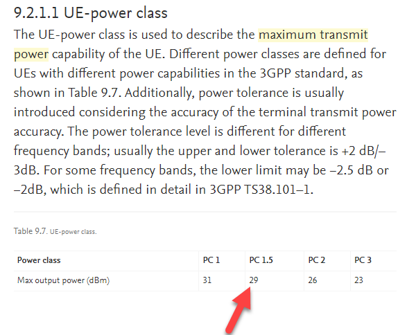

Also seen PMAX 29 in SIB1.Is it possible ?
Yes.
https://www.sciencedirect.com/topics/engineering/maximum-transmit-power
It can even be 31. :wink:

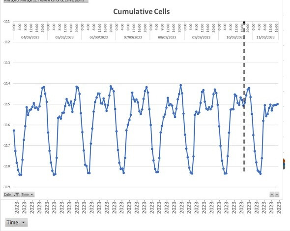

PMAX on the network was in NOT Configured Mode.
But we have modified it to 23.
We do have benchmarked the KPIs didn’t found any improvement in N/W.
UL Interference  after PMAX
UL Interference after PMAX.
To control interference from UEs transmitting at high power.
We did the same thing on our network awhile ago, we configured Pcmax to 23 dbm.
We analyzed the city sites alone and rural sites alone, we found slight improvement in city sites on Uplink traffic; however rural sites didn’t improve.
