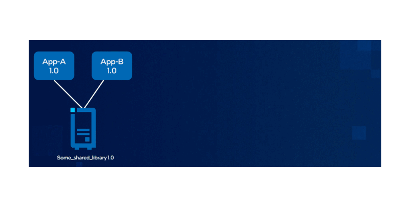

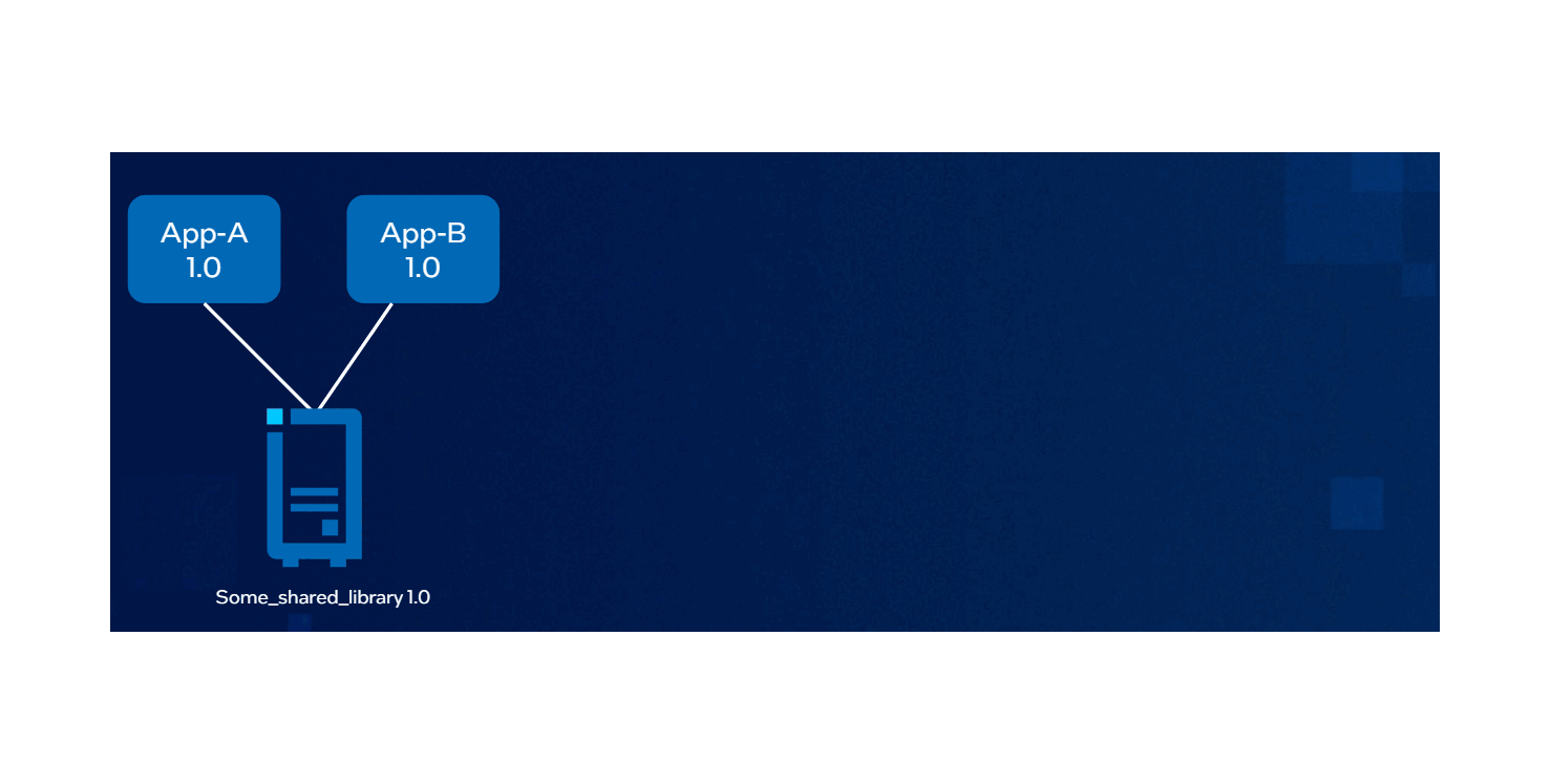

- Me: Let’s assume that we have one physical server using one operating system (OS) with two apps installed on it, which are app A, version 1.0 and app B, version 1.0 and both apps are using a shared library v1.0. When app A has an update to v2.0, the shared library needs to be updated as well to shared library v2.0 which will make app A perform well, however app B will fail as it needs shared library v1.0 and so you can choose either to wait for both apps to have the same dependencies or separate the two apps in two different servers. So, you can imagine if every app needs a dedicated server with its own dependencies, we’ll have a huge number of physical servers in enterprise data centers. So, applications were deployed in separate servers not necessarily for performance or security reasons, but to guarantee stability following updates. Same applied for telco world, as we have a separate HW for each function, so for example, SGSN equipment is only SGSN and can’t be MSC or HLR and you can’t combine the SGSN, MSC, and HLR in one HW.
