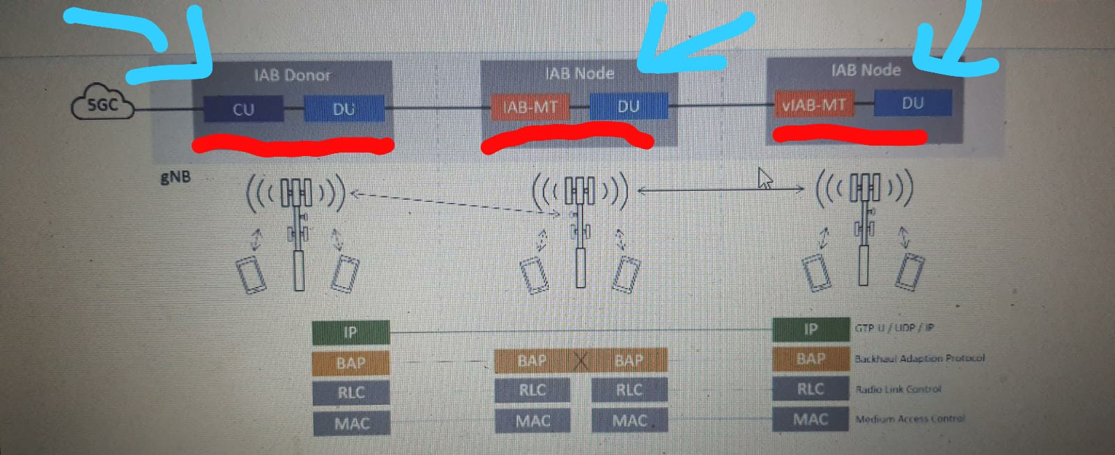

But another query: why are we cascading and distributing just DU units (DU components) in the IAB node and not also the CU components?
I mean, we are like just having CU+DU in the donor (regular gNB) and its childs (IAB nodes) are having DU component distributed and not CU. Why not also CU distributed?
See please image below for more illustration:
I am not an Expert on IAB but one could think of having centralised CU for better management of CU’s either with or without Cloud.
There also could space restriction in remote sites where traditional backhaul is not possible so IAB is considered.
I’m with you. But why not centralized DU and distributed CU units?
Why do we prefer to centralize CU and distribute DU components? An not opposite?
What trade-off I’m gaining from?
We are like spliting DUs components but CUs not… here is my confusion.
Because there can be 1 CU connected to multiple DU , but you don’t have many CU connected to 1 DU.
CU processes higher layer protocols - RRC and PDCP , that are not realtime hence can be centralized. DU process lower layers example , MAC that is realtime , hence transmission delay cannot be above a limit due to HARQ. Therefore cannot be arbitrarily centralized.
