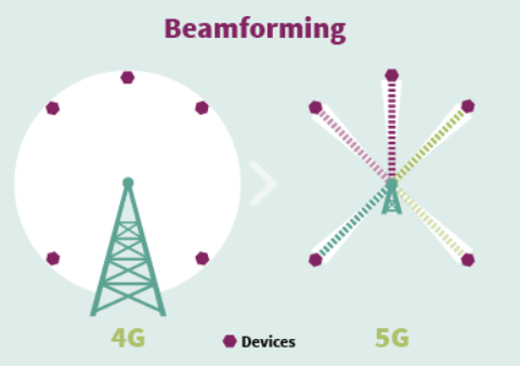

Why beamforming not so used in LTE?
Guys,
Massive MIMO technique is also present in LTE, then why beamforming was not there in LTE?
Massive MIMO means beamforming, there cannot be one without another.
In LTE we just didn’t have AAU (Active Antenna Unit), we had standard 4T4R antennas.
And for such antenna beamforming is not possible
Once you get AAU there will be massive MIMO and beamforming, no matter if 4G or 5G, or both fo them in case of DSS.
