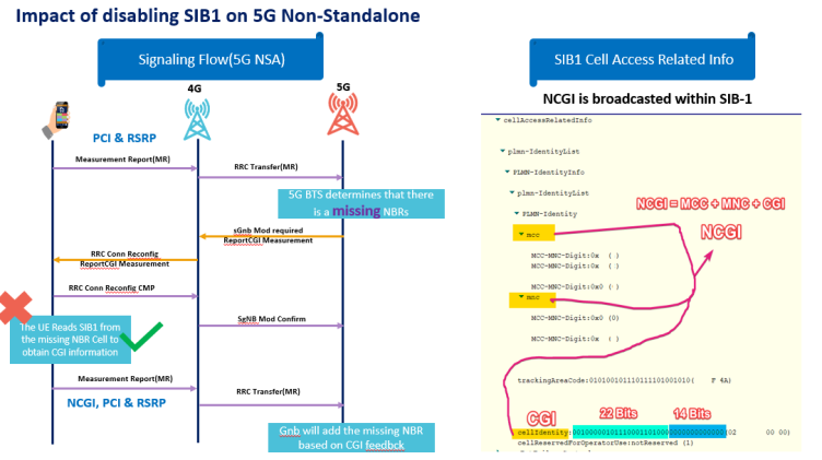

The explanation for why 5G ANR is not working when SIB1 is disabled in the 5G NSA Network.
This article explains why 5G ANR is not triggered and does not work whenever SIB1 is disabled in the 5G Non-Standalone network.

No what I meant that the target 5 (Cell/site) will broadcast SIB1 information to all UE, accordingly the UE will read SIB1 (system information) from target cell to obtain CGI-Info.
As you know that In NSA networking, SIB1 transmissions are optional.
Then to ensure that missing neighboring cells can be automatically detected and added, all cells needs to send SIB1 so that the UE obtains CGI-Info.

No My friend. 5G ANR in NSA architecture works smoothly if NR SIB1 transmission is enabled on gnodeB. NR system information is broadcasted on PDSCH. In NSA mode UE does not have RRC layer with 5G. It does not mean it can not decode NR system information shared on 5G PDSCH channel. UE can read all 5G logical channels including PDSCH, PDCCH etc.
LTE-NR ANR via X2 interface you just mentioned is also available in Huawei RAN as well but it is something different with event based ANR explained above. In ANR over X2 interface gnodeB will give external neighbor information to master enodeB upon receiving X2 setup request message and Enb will add neighbors without the need to read NR SIB1. In other scenario of this option after X2 setup between LTE and NR if any configuration changes happen on NR side (such as PCI or gnodeB ID modification etc.) gnodeB will automatically ask peer enodeBs to update external neighbor relations on their side.
It first read MIB and there is pdcchconfigSIB1 and then it knows where and how to look and decoded SIB1 NR.

UE can decode sib1 only when it requires CGI reporting, in other situation you will not measure it on field in NSA.
And also require UE capability support, as I remember.
