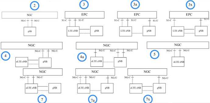

Whether a standalone 5G Core can support a 4G RAN?
Yes if eNB upgrade to support NG inte4face. We can say ng-eNB.
Here PDCP layer upgrade to support SDAP.
No.
You need a dedicated Core for 4G.
5G Core nodes are not backwards compatible.
NG eNB can connect with 5GC as per option 7.
RAT fallback is a use case for this!
Yes and No.
Yes, as per 3gpp options.
But practically, if you are deploying 5GC in parallel existing EPC, why will you still have NSA?
Like opt-7.
And further incur costs to upgrade eNBs.
No and here comes Dual Mode Cores to fill in gap.
I am saying that it is possible as per SPECS.
I know you can do these combinations, but having a “100% pure” 5G with 4G is not possible.
That means PDCP layer after upgrade will support QoS Flow.
