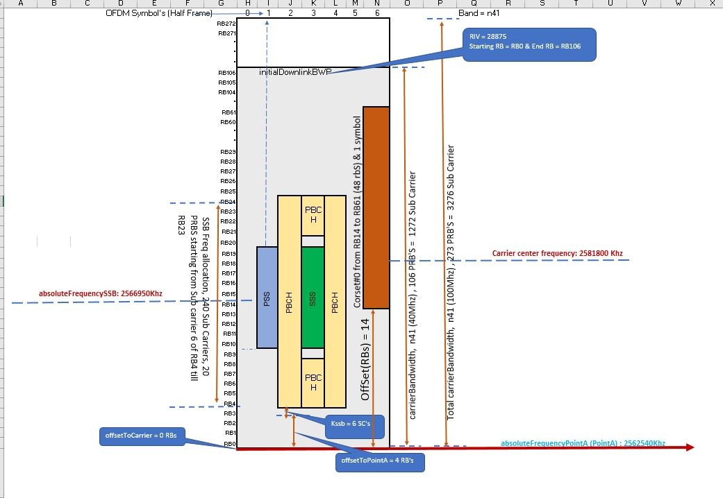

Here you can see clearly:
SSB carries mib and pss/sss.
Mib carries information about coreset 0, i.e. on which PDCCH coreset 0 is to be transmitted.
When UE decode coreset0, it can then decode PDSCH that carries SIB1 info
Hence SSB is not on coreset0.
Rather, SSB carries info about how and where to find coreset0.
