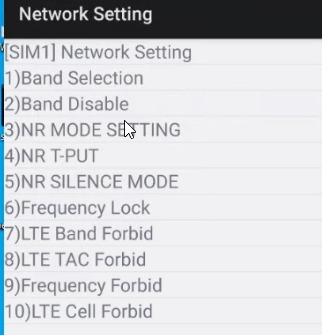

When NR mode is set to SA + NSA, how device prioritize either SA or NSA?
NSA, SA or NSA+SA, 3 modes can be set 1

n1 mode can be set from phone either SA, NSA or SA+NSA.

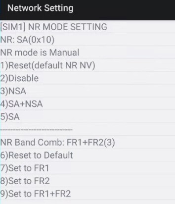

So, need advices on n1 mode in device side.
NSA, SA or NSA+SA, 3 modes can be set.
NSA, SA or NSA+SA, 3 modes can be set 2
Yes we can have same cell support for NSA or SA mode by using deployment mode parameter.
Most of UE support NSA+SA and in 5G auto mode setting.
UE will try first to register with SA cell by RACH procedure.
And if it’s fine then PS call work over SA cell.
Otherwise UE will enter into NSA mode for same cell by X2 setup between 4G and 5G cell and then SCG addition.
So in summary: Device always try for SA first. If it gets failed to latch on SA cell due to RACH issue, RRC reject etc. then device try for NSA mode. Same cell can be SA or NSA in network as per deployment mode parameter set.
