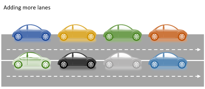

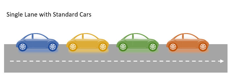

You can start imagining a highway facing traffic congestion.
So, you may add more lanes (taking up new land) to the highway sideways to fit more cars.
That’s CA – CARRIER AGGREGATION!

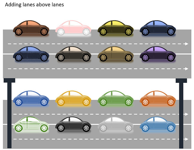

Continuing, imagine there are no more lands to buy and build new lanes. For example, because there are houses on either way of the highway. Then you must build additional decks upwards.
That’s MIMO!

Perfect example with the additional road decks for MIMO.

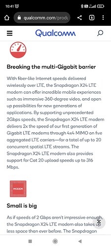

Qualcomm X24 LTE chipset support LTE cat20, 4-layers DL * 5 carriers.
