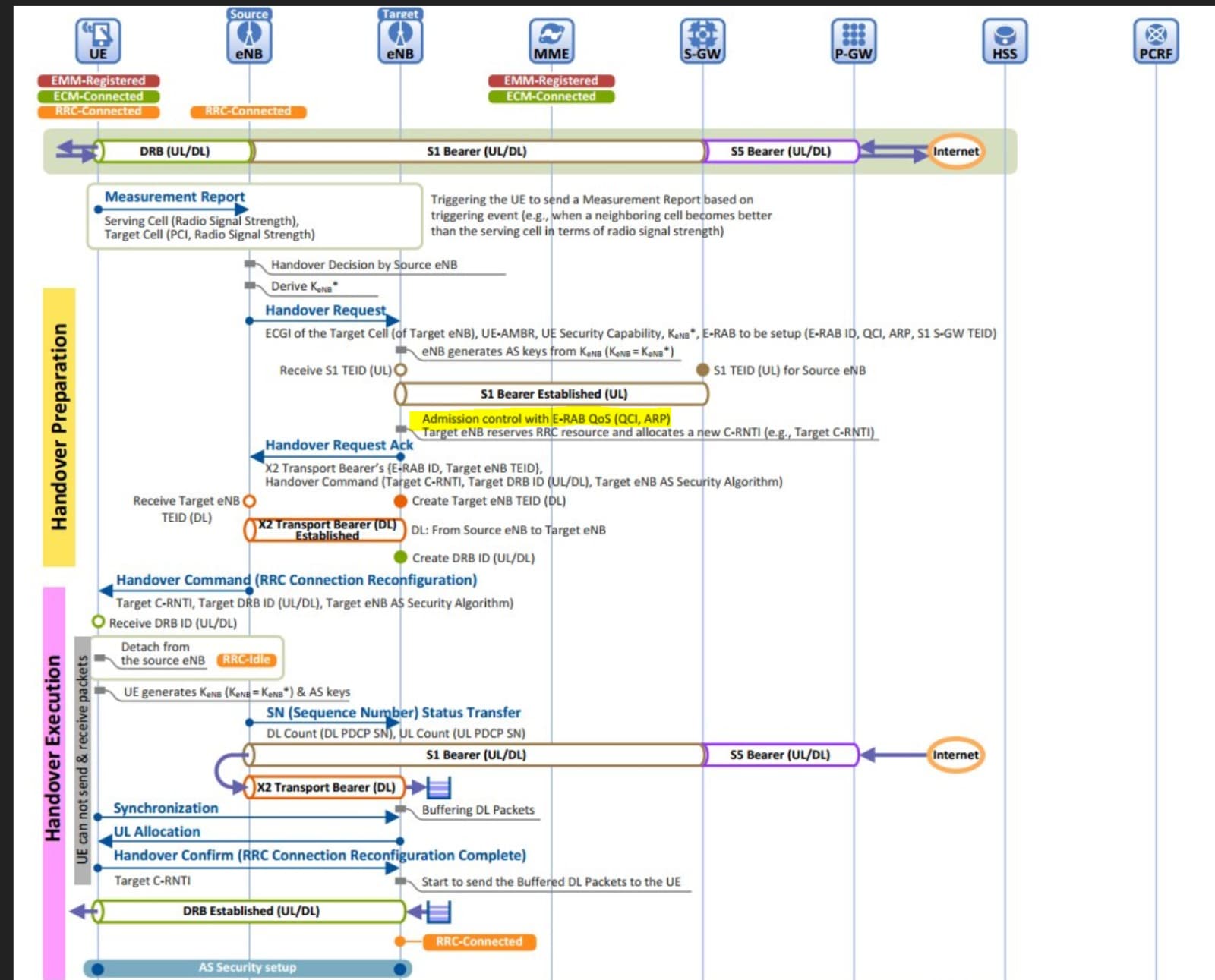

Reference (help) image sent later in discussion:

However if A3 measurements is there, A1 should not stop HO req message.
A3 is subject of admission control on target eNodeB.
This is one reason you may not see it happening, even if reported.
Complete Detail of Intra-LTE Handover procedure using X2 interface
Source: LTE X2 Handover Call Flow Procedure | 3GLTEInfo
