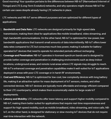

Also, our good friend chat gpt answers this:

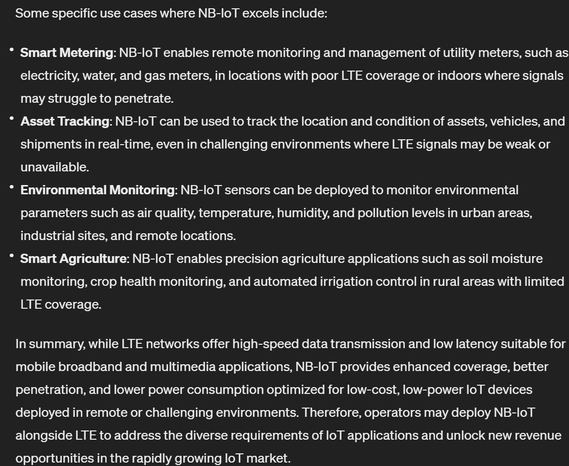

Also, some specific use cases where NB-IoT excels include:
Means, all these use cases can also be run on LTE but due to less bandwidth requirement and battery power saving (long life) and for fast response as there is very low signalling in NB-IoT?
Yes, this is correct!
