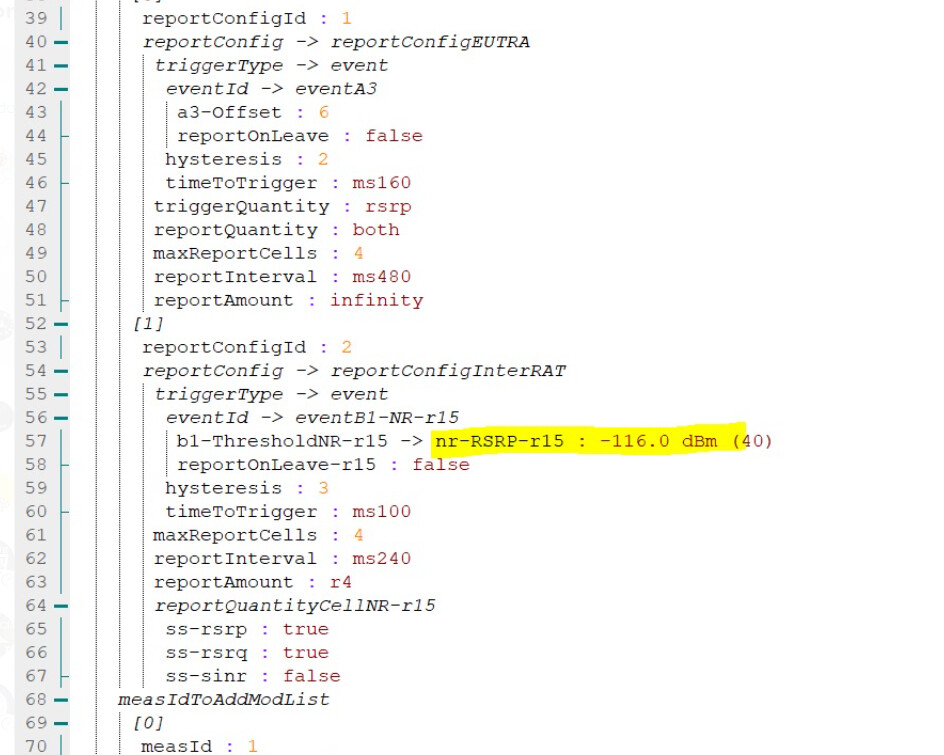

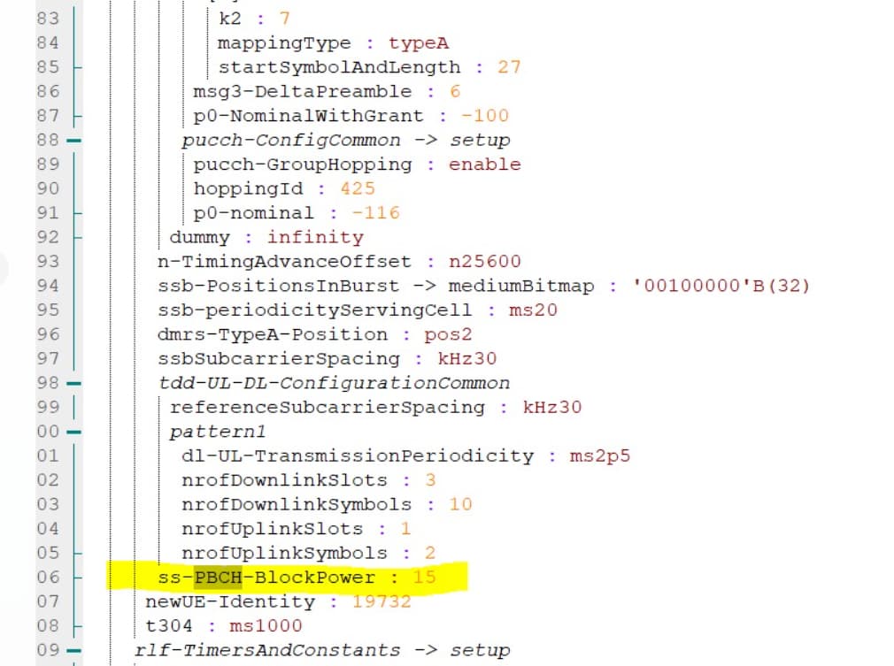

I would say -116 dBm for B1 NR event, but it depends also on SSB PBCH Block Power.
Is there any mapping between SSB PBCH block power and block power in TDD on the 3.5 GHz band?
Here is a case with -116 dBm:
And SSB power was 15 dBm:
This is b1 for ENDC steup in 5G NSA right?
Yes, correct.

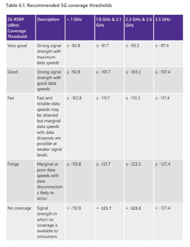

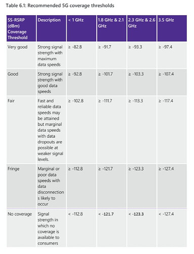

Please what do think about this table?
It depends if you have UL in LTE it may work but -127 dBm for me it is too much.
Usually A2 NR event to remove NR is at -120 or -124 dBm.
