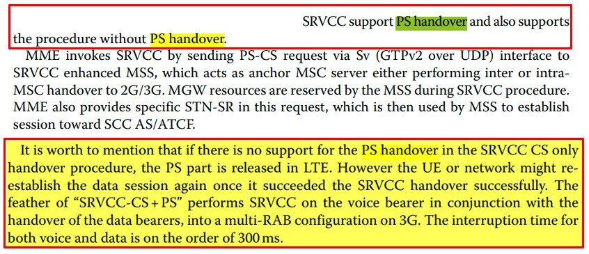

SRVCC is capable of performing this handover for both CS and PS domain or CS Domain only

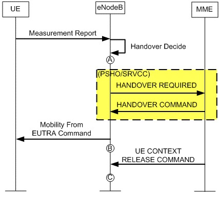

If UE is moving from VoLTE TO VoNR is it called SRVCC?
In case of VoLTE call, if coverage gets weak, we prefer to transfer calls from VoLTE to 3G/2G.
SRVCC performs / supports the PS handover or PS + CS Handover from VoLTE to lower RAT.
