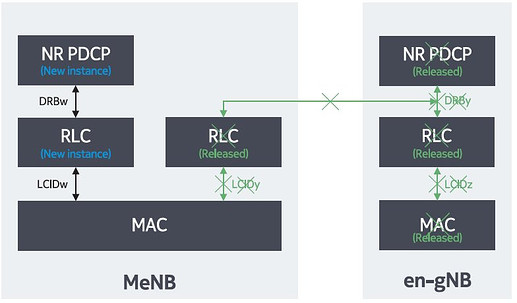

After initial attach, the radio bearer will be attached to the 5G NR PDCP entity if the LTE nodeB supports ENDC ( have X2 links to 5G gnb configured by Operator). This allocation is independent of the status of 5G SCG Physical layer status from 5G gNB.
“To reduce the data loss and data duplication during bearer type change without affecting the other MCG bearers of the connection, the data bearer which is eligible to become an SN-terminated split bearer is established in the eNB as MCG bearer with NR PDCP.”
There you go.

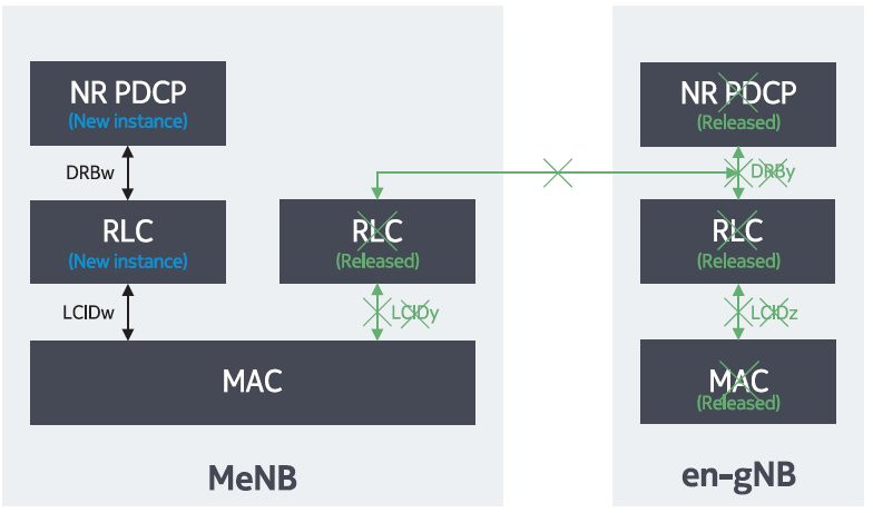

This should be how your stack look like after, for example, you run out of NR coverage and have PSCELL removed.
There is no image for the scenario before addition, but would be like this.
Yes, Makes Sense.

One thing we must differ is between PDCP version and the stack view, as showed in the picture I’ve sent.
You can use a NR version of PDCP while running purely on LTE.
You are absolutely right. LTE stack can have both PDCP version as below.
