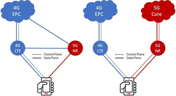

Hi,
For NSA, we have different varieties such as option 3 with its variants (most famous one is option 3x which is deployed at many MNOs around the world).Also there is option 4 and option 7 with their variants. Here main difference between NSA options are They have different core, so option 3 is connected to the 4G core (EPC) while both option 4 and option 7 are connected to the 5G core (5GC). But take care that for option 7, the master node (MN) is the eNB and the secondary node (SN) is gNB while for option 4, MN is the gNB and SN is the eNB.

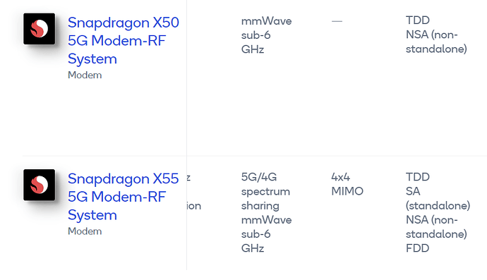

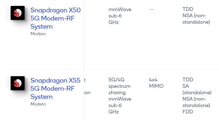

Moreover, terminal development path is from NSA to SA, some UE currently just support NSA only, no SA. Such as Qualcomm X50 support NSA, later X55 support NSA+SA.

NSA and SA refer to different deployment options in the context of 5G (fifth-generation) wireless technology.
𝑡𝑺𝑨 (𝑡𝒐𝒏-𝑺𝒕𝒂𝒏𝒅𝒂𝒍𝒐𝒏𝒆): In Non-Standalone mode, 5G networks are deployed on top of existing 4G LTE infrastructure. The control plane remains on the LTE network, while the user plane uses both LTE and 5G. This means that 5G relies on the existing 4G core network for certain functions.
𝑺𝑨 (𝑺𝒕𝒂𝒏𝒅𝒂𝒍𝒐𝒏𝒆): In Standalone mode, 5G operates independently without relying on any existing 4G infrastructure. Both the control plane and user plane functions are implemented in the 5G core network. SA is considered the ultimate form of 5G deployment, offering the full benefits and capabilities of the new technology.
In summary, NSA leverages existing 4G infrastructure, while SA is a completely independent 5G deployment.
The choice between NSA and SA depends on various factors, including the existing network infrastructure, deployment strategy, and the desired level of 5G functionality.
