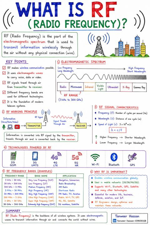

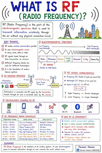

What is RF (Radio Frequency)?:satellite_antenna: What is RF (Radio Frequency)?
Every wireless communication begins with RF (Radio Frequency).
RF refers to the portion of the electromagnetic spectrum used to transmit and receive information wirelessly. It is the foundation of modern communication systems, enabling devices to connect without physical cables.
:satellite_antenna: RF powers technologies such as:
:white_check_mark: 2G GSM
:white_check_mark: 3G UMTS
:white_check_mark: 4G LTE
:white_check_mark: 5G NR
:white_check_mark: Wi-Fi
:white_check_mark: Bluetooth
:white_check_mark: GPS
:light_bulb: Why is RF important?
Without RF, mobile communication, internet connectivity, satellite navigation, and wireless networks would not exist. Every RF Engineer should have a strong understanding of RF fundamentals before moving on to advanced topics like LTE, 5G, Drive Testing, and Network Optimization.
:open_book: This is Part 1 of my Telecom Mastery Series, where I’ll be sharing practical telecom knowledge from Basic to Advanced.
:backhand_index_pointing_right: Follow my profile for daily telecom learning and professional RF engineering content.
