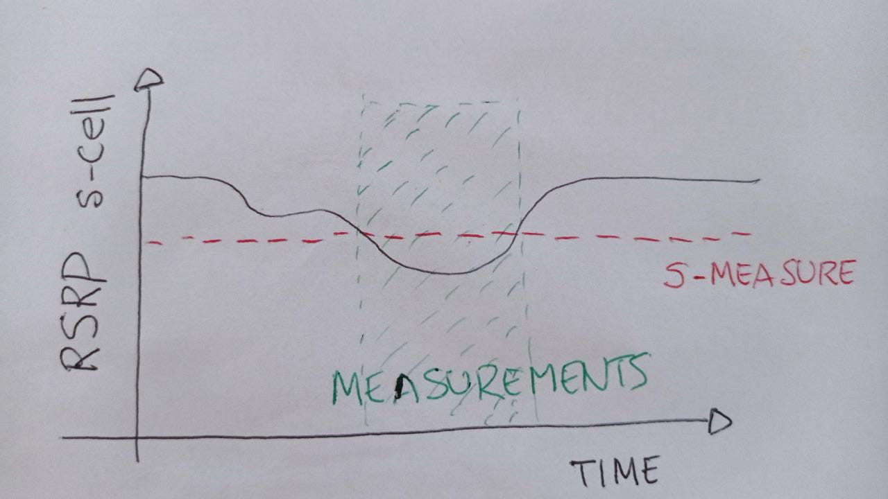

Anyone having ideas about s-measure in LTE?
Used for intra cell or inter as well?
Used in neighbours measurement.
It is used to start any measurement.
If s-measure is kept very low, let’s say -140 dBm, then UE will not measure any intra or inter nbr cell.
s_Measure
Is one of the IE in the rrcConnectionReconfiguration (atleast R8 onwards).
Serving cell RSRP threshold controlling whether or not the UE is required to perform measurements of intra-frequency, inter-frequency and inter-RAT neighbouring cells.
Both intra and inter Freq ** for connected mode.
