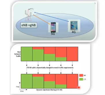

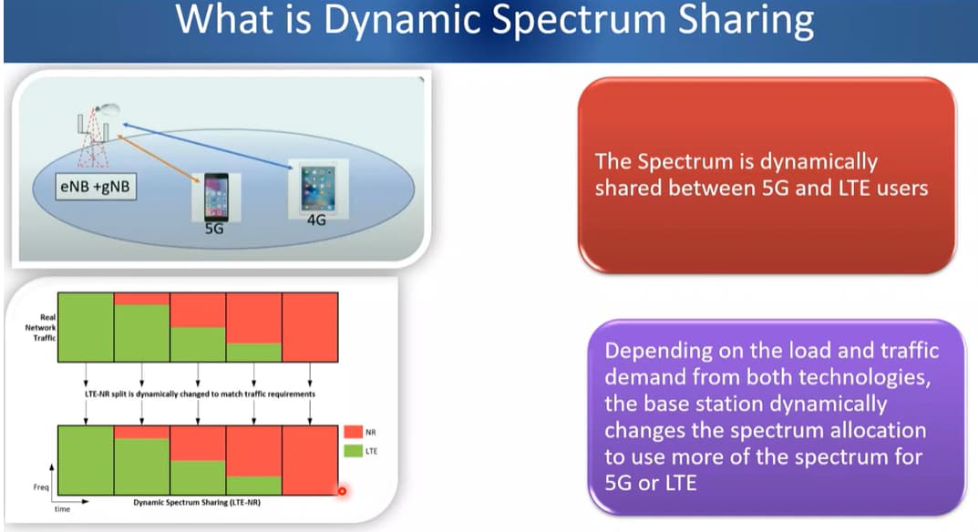

Dynamic Spectrum Sharing is a technology that allows the deployment of both LTE and 5G NR in the same frequency band and dynamically allocates spectrum resources between the two technologies based on user demand.
Suppose, without DSS, an operator that has 20 MHz of mid-band spectrum would have to split that spectrum in two. In other words, they would have to allocate 10 MHz of spectrum to 4G LTE and cram all their LTE users into that 10 MHz of spectrum. Then the remaining 10 MHz of AWS spectrum could be used for 5G, even though initially there will only be a minimal number of 5G users.
With DSS, an operator doesn’t have to split that mid-band spectrum or have a dedicated spectrum for either 4G LTE or 5G. Instead, they can share that 20 MHz of spectrum between the two technologies.

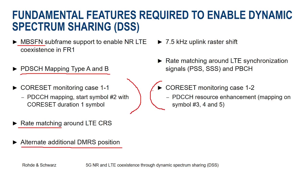

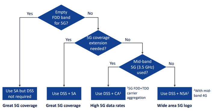

Decision tree for DSS feature selection from Nokia.
Check out this 12 pages long — White Paper : Nokia dynamic spectrum sharing for rapid 5G coverage rollout.
Spectrum re-framing as NR Grow vs Dynamic Spectrum Sharing,
Resource Allocation in DSS,
4G and 5G Frame structure,
5G Resource Grid,
5G NR in 4G LTE Subframe,
Cell Reference Signal and Antenna Ports in 4G LTE,
5G PSS and SSS and SS Block,
Location of NR SSB in time domain,
One SS Burst Set,
Use of LTE MBSFN Sub Frame for DSS,
Combining DSS Deployment Options,
DSS in Uplink,
NOKIA DSS Solution,
Ericsson DSS Solution,
Case Study of Verizon Wireless USA
