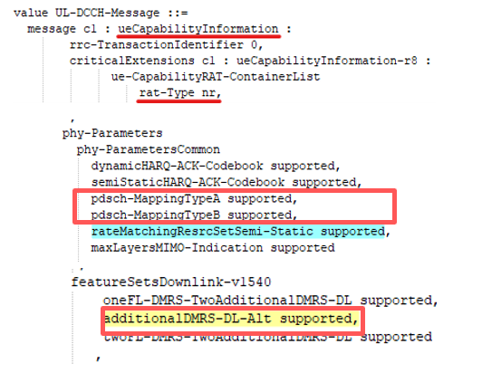

Great explanation, I am assuming the UE declare its CRS rate matching capability in the UE capability message it sends to the network? Can anyone share a snapshot of that message showing the parameter.
In blue
