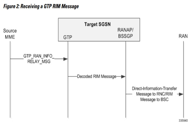

An example picture for your information:
For example for the RIM check these counters or messages and see if these are pegging any data or not.
In this case, the SGSN has to decode the incoming GTP message correctly and forward the RIM message to the destination RNC/BSS.
