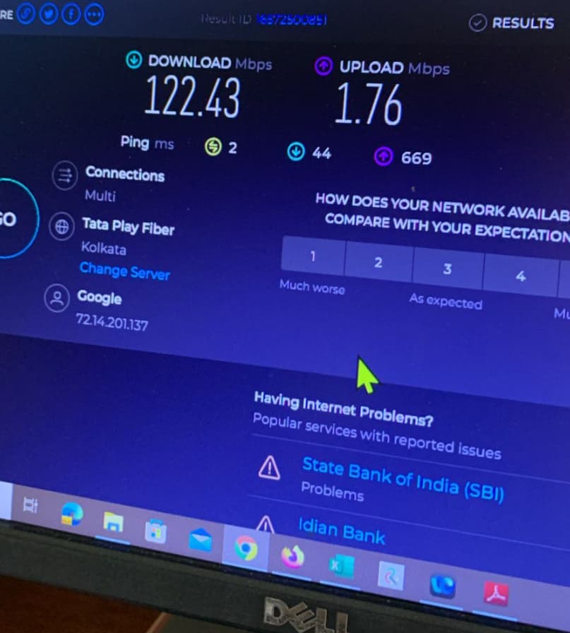

What could be the reason for extremely low uplink speed in FTTH?

How about DL speed?
Downlink is very good.
Receive level is good around -15 dBm.
Also:
  • Maybe wrong config from the Core side for UL AMBR.
I can see that you are testing using laptop. Certain applications that work in the background might be using uplink bandwidth without your knowledge. Try make speed test using mobile phone.
