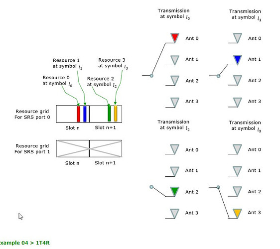

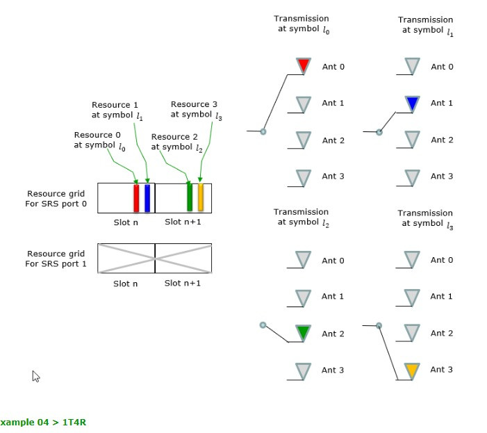

To my knowledge SRS are transmitted on the UE RX antenna.
So 4 RX antenna 4 srs signals transmitted.
Like this:
More details here:

srs are used by gNodeB to calculate the air interface matrix
At least this is how Huawei does it.
srs are very important.
