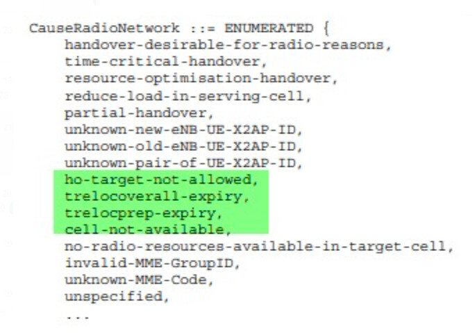

If there is no response from the target eNB to the HANDOVER REQUEST message before timer TRELOCprep expires in the source eNB, the source eNB should cancel the Handover Preparation procedure towards the target eNB by initiating the Handover Cancel procedure with the appropriate value for the Cause IE, e.g. “TRELOCprep expiry” .

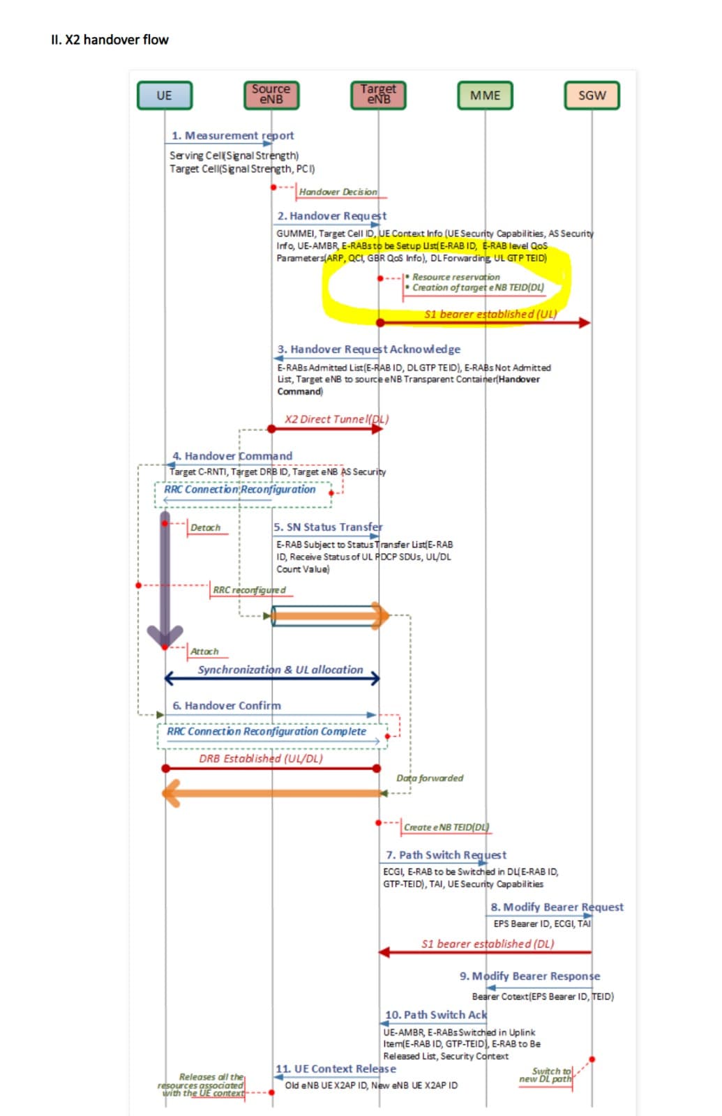

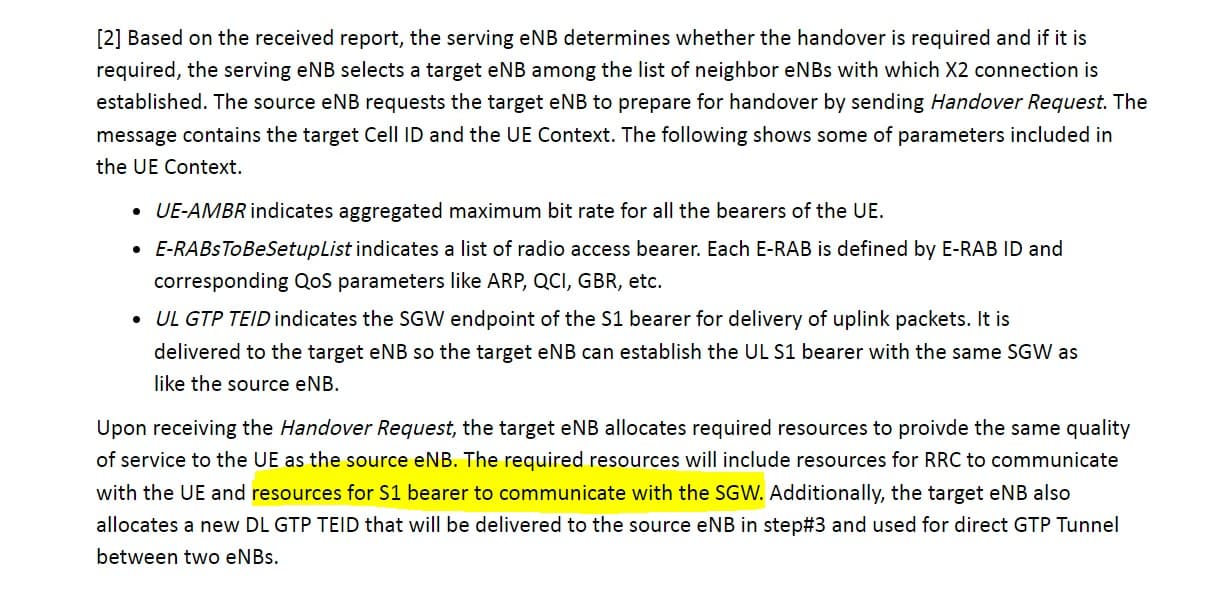

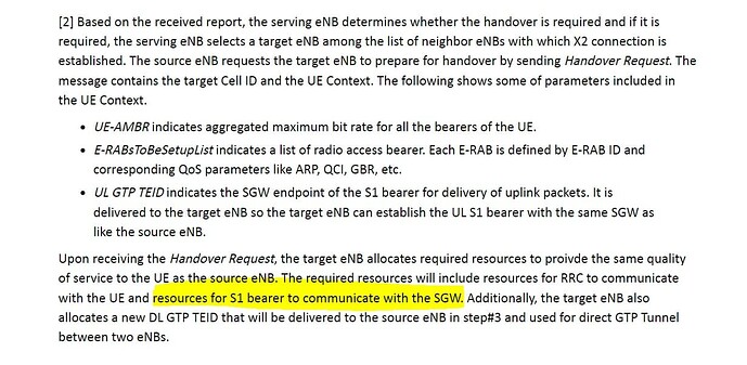

It means call flow fails at area highlighted in yellow:
More precisely it fails here:

Now concept is pretty much clear!
