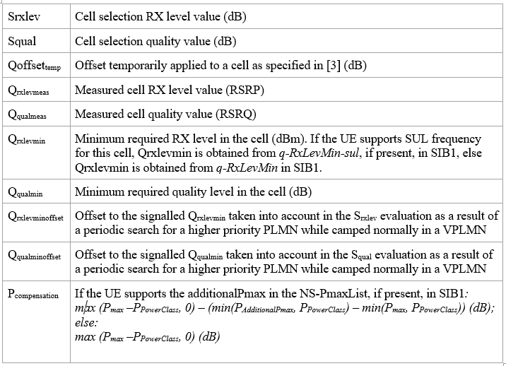

The measurement rule for Intra frequency cell reselection purpose is if the serving cell fulfils
Srxlev > SIntraSearchP and Squal > SIntraSearchQ, the UE may choose not to perform intra-frequency measurements. Otherwise, the UE shall perform intra-frequency measurements.
Where,
• Srxlev = Qrxlevmeas – (Qrxlevmin + Qrxlevminoffset) – Pcompensation - Qoffsettemp
• Squal = Qqualmeas – (Qqualmin + Qqualminoffset) - Qoffsettemp
