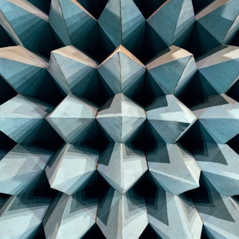

:small_blue_diamond: TRP (Total Radiated Power) – Quantifies how efficiently the device transmits RF energy, measured across a 3D spherical field in an anechoic chamber.
