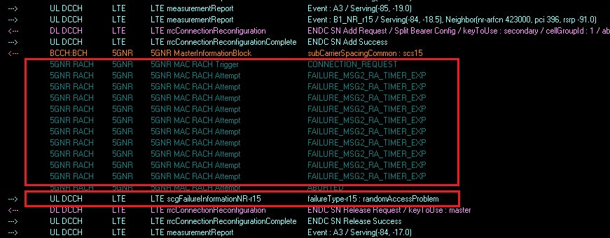

5GNR MAC RACH Attempt - FAILURE_MSG2_RA_TIMER_EXP
UE didn’t get msg2.
Looks like UE did not receive msg2 .
But this is what UE thinks .
But there can also be other issues:
  • gNB might not have received RACH at all from UE - need to check gNB logs for RACH.
  • PDCCH blocking at gNB if Cell is Loaded.
RACH attempt initiate in low RSRP , MSG1 is not received by gNB, then in the UE MSG2 timer expire. After 10 attempts, RACH procedure is aborted.
check 5G coverage or increase reambleTransMax to 20
1- gnb may already send Msg2-RAR but UE can not receive it. Pls check coverage.
2- gnv may not send Msg2-RAR to UE. Maybe, lack of sxheduling resource such as CCE, Pdsch. Pls check coreset RB number, CCE ul/dl ratio,…
This kind of problem can appear due to misconfiguration, excessive load or software/firmware problem at the Base Station (BS)
