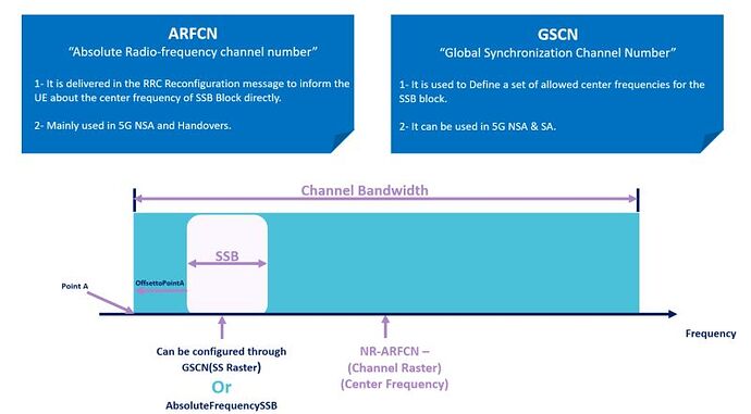

What are the methods used to configure SSB Frequency Location?
Generally, two main ways are used to configure the SSB Frequency position.
  1. ARFCN “Absolute Radio-frequency channel number.”
  • It is delivered in the RRC Reconfiguration message to inform the UE about the center frequency of SSB Block directly.
  • ARFCN is used to calculate center channel bandwidth and Absolute-SSB-Frequency and is called channel raster.
  • The Channel Raster has a relatively high resolution using Low-Frequency scan granularity (15,30,60 & 100Khz).
  • The Absolute Radio frequency Number is delivered in the RRC Reconfiguration message, which means that the UE will receive the SSB Frequency domain position directly from the 4G Leg.
  • Mainly used in 5G NSA and Handovers.
  1. GSCN “Global Synchronization Channel Number.”
  • GSCN stands for Global synchronization channel number, can be used in both 5G-NSA & 5G SA, and is known as a Synchronization raster.
  • The Synchronization Raster defined a set of allowed center frequencies for the Synchronization Signal / Physical Broadcast Channel block.
  • The Synchronization raster has a relatively low resolution(1.2,1.44&17.27 MHz) to reduce the number of positions a UE must check when completing a band scan, i.e., the band scan procedure becomes faster and more efficient.
  • It can be used in 5G NSA & SA.
