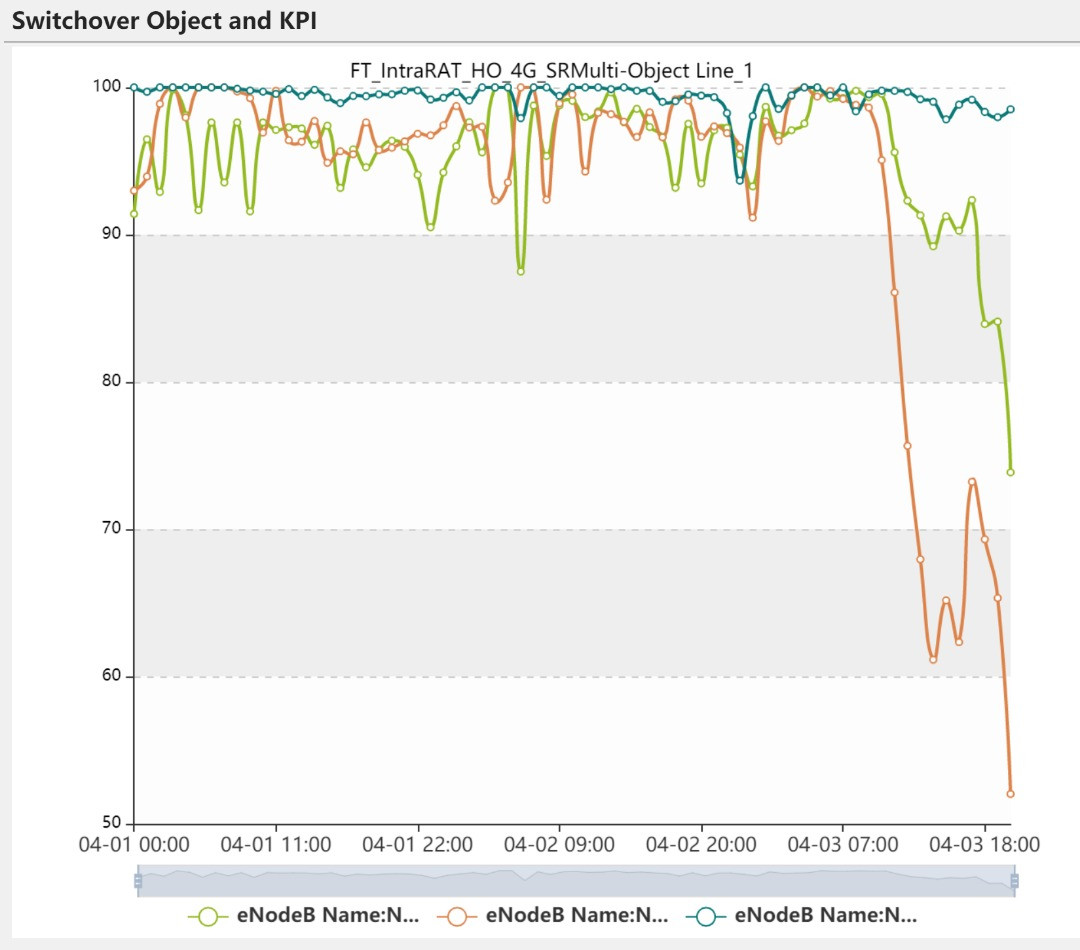

My current issue is that “Succ/Exec” is having good values while “Succ/Prep” is degrading.

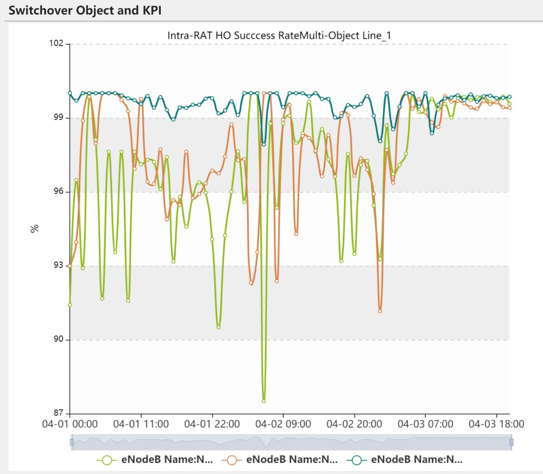

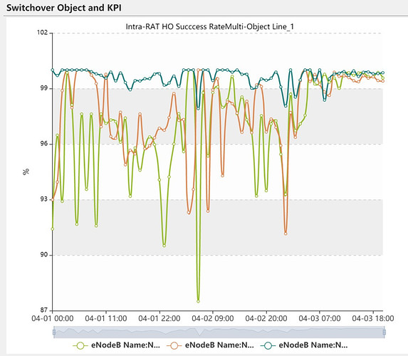

I’ll show you trend of one site which had ANR disabled (via CELLALGOSWITCH).
Yes I did, it’s mostly Intra.
Any recent TAC or PCI changed?
Have you check target cell?
Any known issue?
Succ/Prep:
Succ/Exec:

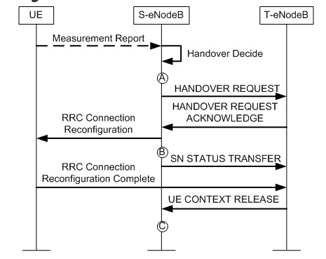

Handover preparation is the procedure between source & target enb: from step A to B. target enb prepare radio resource for incoming UE, if admission failed it will reject.
Handover execution is the procedure between source enb and UE: from B to C. After resource admission at target enb is successful, source enb send UE information about new cell for UE jumping to.
