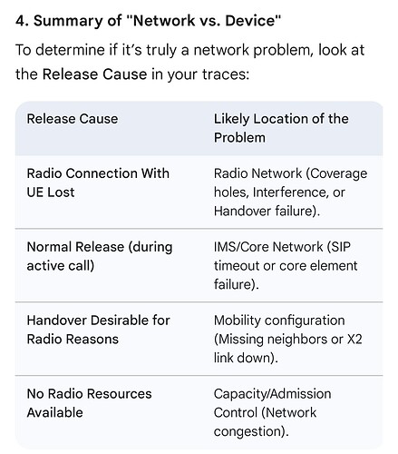

4. Summary of “Network vs. Device”
To determine if it’s truly a network problem, look at the Release Cause in your traces:
Resources links for your deep-dive:

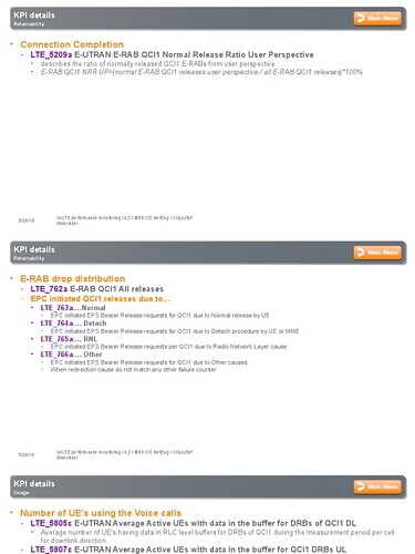

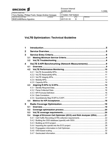

​VoLTE Performance Monitoring:
​QCI-1 VoLTE Performance Metrics & Formulas — Detailed counter breakdown.
​VoLTE Optimization Technical Guideline — Excellent walkthrough of S-KPIs to R-KPIs mapping.
