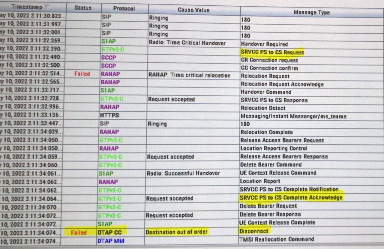

Hi Huawei VoLTE Experts:
In my case, call suddenly getting dropped after SRVCC with:
  • SRVCC PS to CS successful
  • Bearer deleted
  • UE context released
Then call Getting disconnected in random calls at DTAP CC protocol with cause “Destination out of order”
Can someone please comment what can be a possible reason of disconnect and what is this cause?

Cause No. 27 “destination out of order” (UMTS specific cause values for call control) This cause indicates that the destination indicated by the mobile station cannot be reached because the interface to the destination is not functioning correctly. The term “not functioning correctly” indicates that a signalling message was unable to be delivered to the remote user; e.g., a physical layer or data link layer failure at the remote user, user equipment off-line, etc.
UE context release completed. And drop not reporting in counter KPI.
