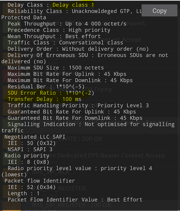

Hi,
I have a problem with sound delay during outgoing calls. My voice reaches the other person with a noticeable delay. This issue does not occur when my conversation partner calls back. When I hold both phones to my ears, the delay is only noticeable during outgoing calls. What could this be?
