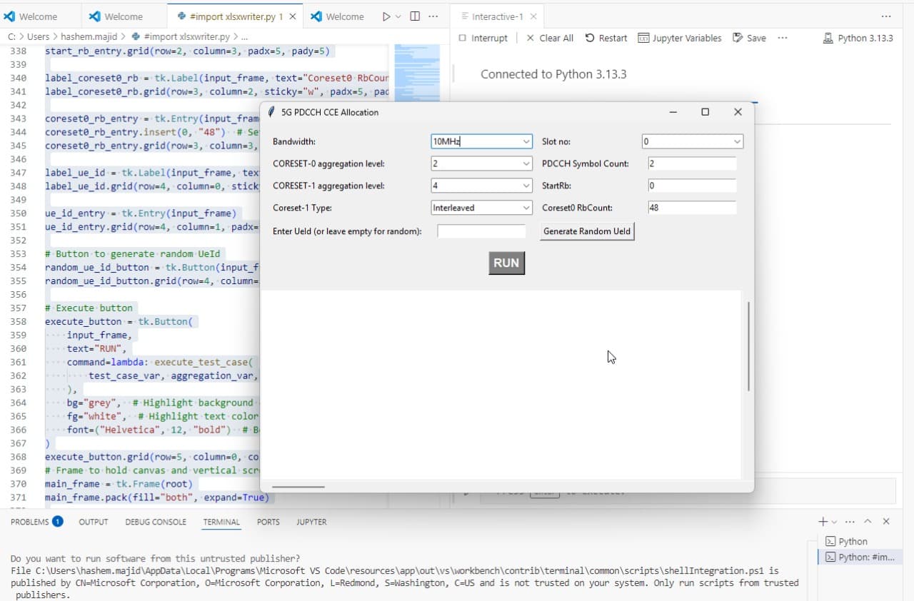

You can use either interleaved/non-interleaved CCE allocation, interleaved gives you better diversity and reduce the probability of RB overlapping while non-interleaved does contiguous CCE allocation which is good for lower bandwidth.

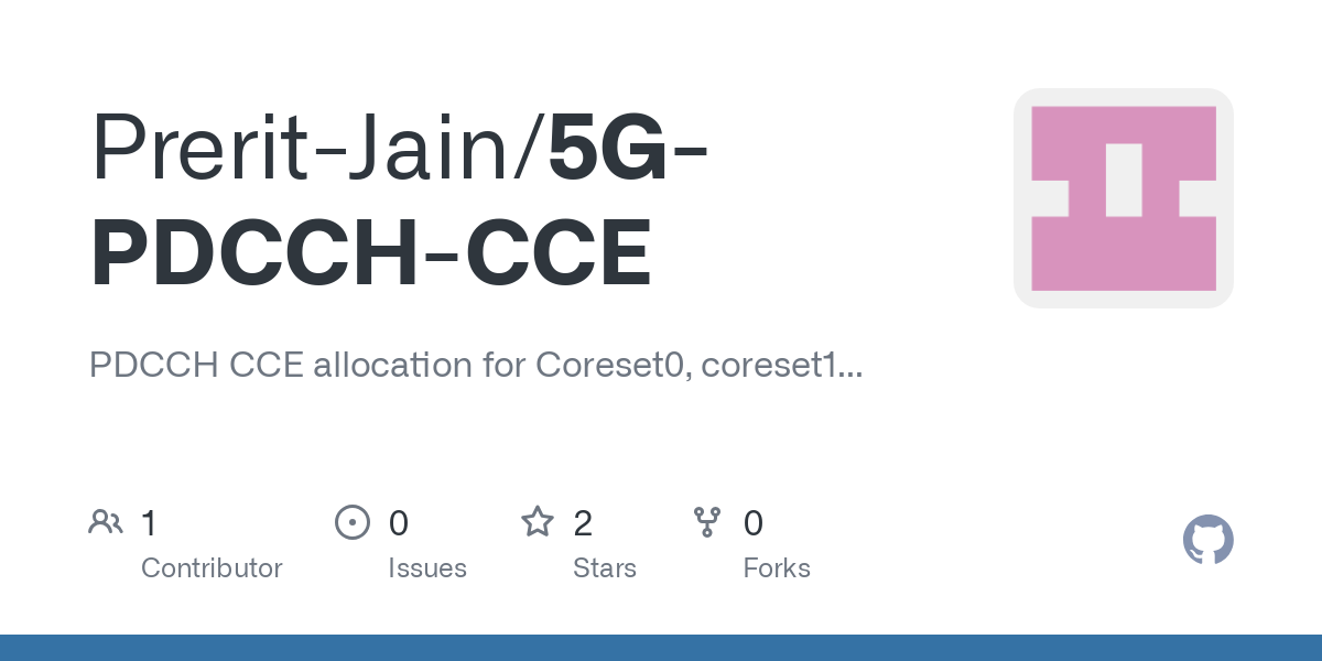

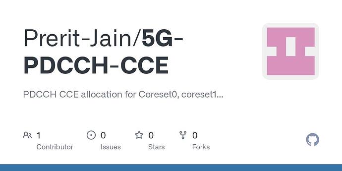

Thus different allocation type can be used according to the system configuration, try out the CCE simulation generated ![]()
