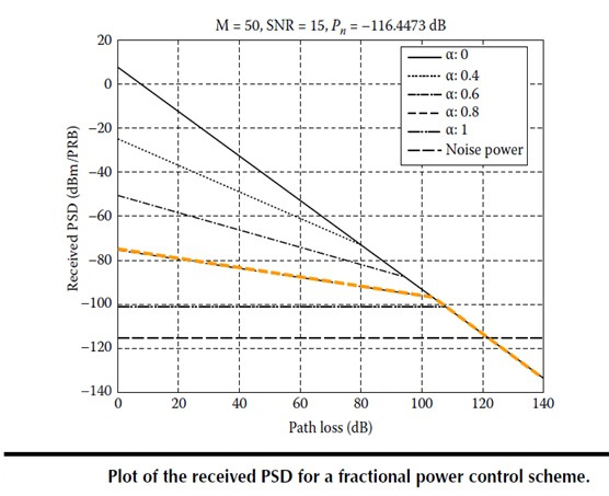

Try to optimize p0nompusch -85 and alpha 0.8 for uplink throughput improvement.
If alpha is not 1 it will create slope of PSD with pass loss.
So it will allow nearby UEs to transmit at more power thus improving their C/I while creating interference for Cell edge UEs.
Improved C/I results in better modulation and thus transmission time reduced.
Alpha 0.7.
Yes with pzeronominalpusch -67.

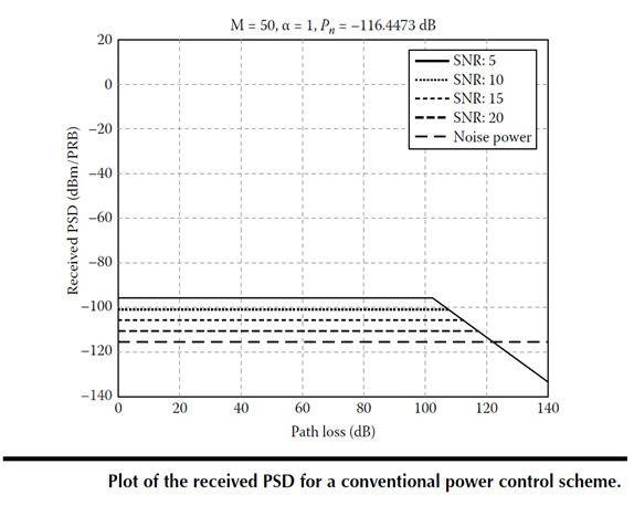

Here Alpha =1 and Received PSD varies (based on pzeronominalpusch):
If alpha !=1 Received PSD target varies with PL:

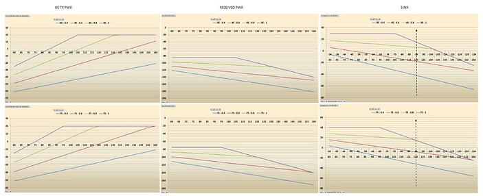

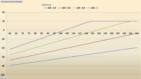

Decreasing the α, without changing P0 shows the UE’ll use less Power, PSDtx, at same PL which will result in low PSD_Rx and hence Low SINR Target (As shown), so we need to adjust P0 too.
This chart is for UE Tx power.
While setting Pzeronominalpusch you need to keep in view UE Tx Power, Received PSD and SINR in mind.

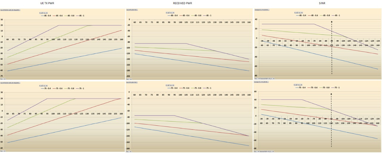

This is comparison of pzeronominalpusch -75 with -85 for different values of alpha.
By increasing P0 point of power limited mobiles are moving to the left.
