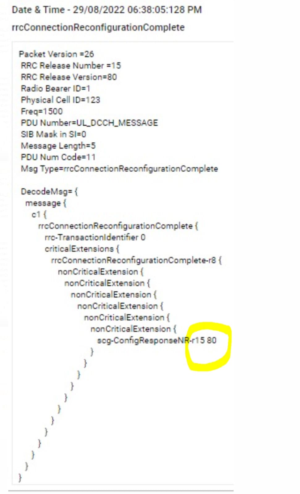

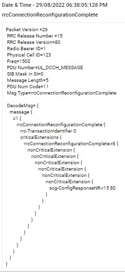

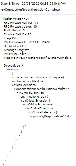

Where can I find the details of scg-ConfigResponseNR-r15 IE?
What does the values 40 and 80 mean for this IE.
It is for special case.
And is an octet.
But no idea what it means.
I searched 38.331 for it and coudl not find it

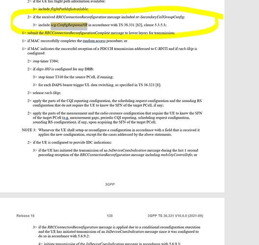

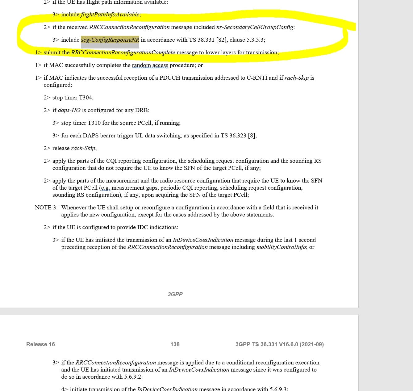

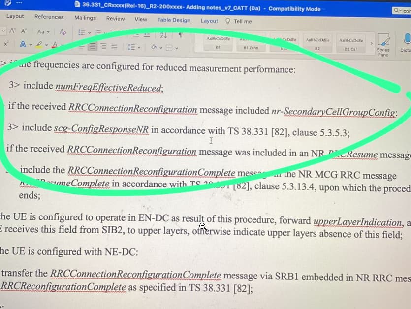

In change request R2-2007286.

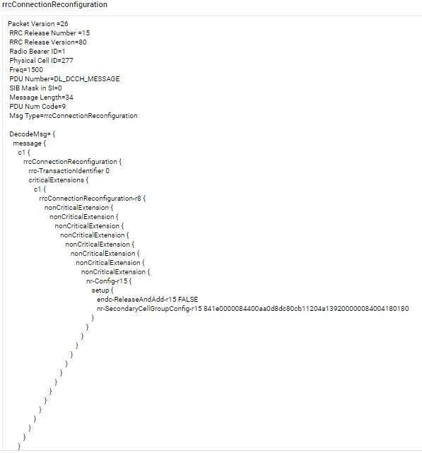

It has been added that if the rrcconnectionreconfiguration msg contains the Nr-secondarycellgroupconfig than add scg-configresponseNR IN accordance however the value of this ie is not mentioned anywhere can you share your rrc Reconfiguration msg with relevant part.

@vikas.nain, from which vendor traces you got this snapshot?
No clear mention about the value anywhere. Might be vendor specific value. Might require vendor doc for this.
Though it seems that 2 different value for the response message might relate to successful update of the configuration and other one is related to configuration failure procedure.
This is max I can observe here after checking available docs.
This is decoding issue.
The tool is able to decode LTE RRC but not embeded NR payload.
As an example 40 here
may be indicative of SCG getting released.
Thanks All.
These are snaps from logs during DT, I was not able to get from eNodeB.
What I have concluded is that 80 is used when SCG is released and 40 while being added.
80 is in reply to this message
Or might relate to successful update of the configuration and other one is related to configuration failure procedure.
Not sure though.
Anyway which vendor data is this?
It’s a Rakuten own phone.
