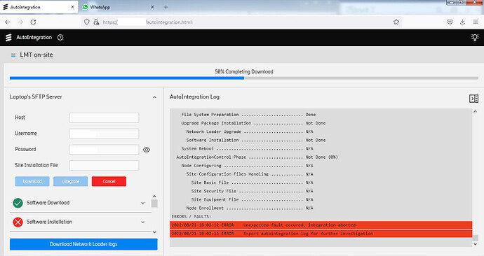

Unable to load script on Baseband 6631
I’m having this error message when trying to load script on BB6631:
Please kindly help
Hi, looks like a problem with Upgrade Package. Can you share full AI log?
@vlr9999, okay I will share
But the same script I used to load BB6630 without no error message with baseband SW package of 18 version.
