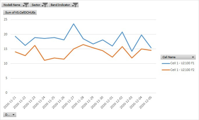

I have user balancing issue for two U2100 cells as shown below.
This is causing several issues including PS code congestion.
Co-site cells are ok and they ALL have the same relevant parameters (CAC, LDR).
PUC & DRD are not active.
Any advice?

Yes I’m facing it in only one sector, both cells are on the same antenna and both have same admission control parameters.
Blind Handover Flag is set to TRUE in UINTERFREQNCELL between those couples.
With Blind Handover Quality Condition being -92.
Here are the other co-site cells of U2100 band.

So, try to setup -4 in idle for F1, and interfrequence relation (F1/F2) and +4 for the parameter qoffest2sn and interfrequence relation (F2/F1).
you need to active DRD based on HSPA user number.
