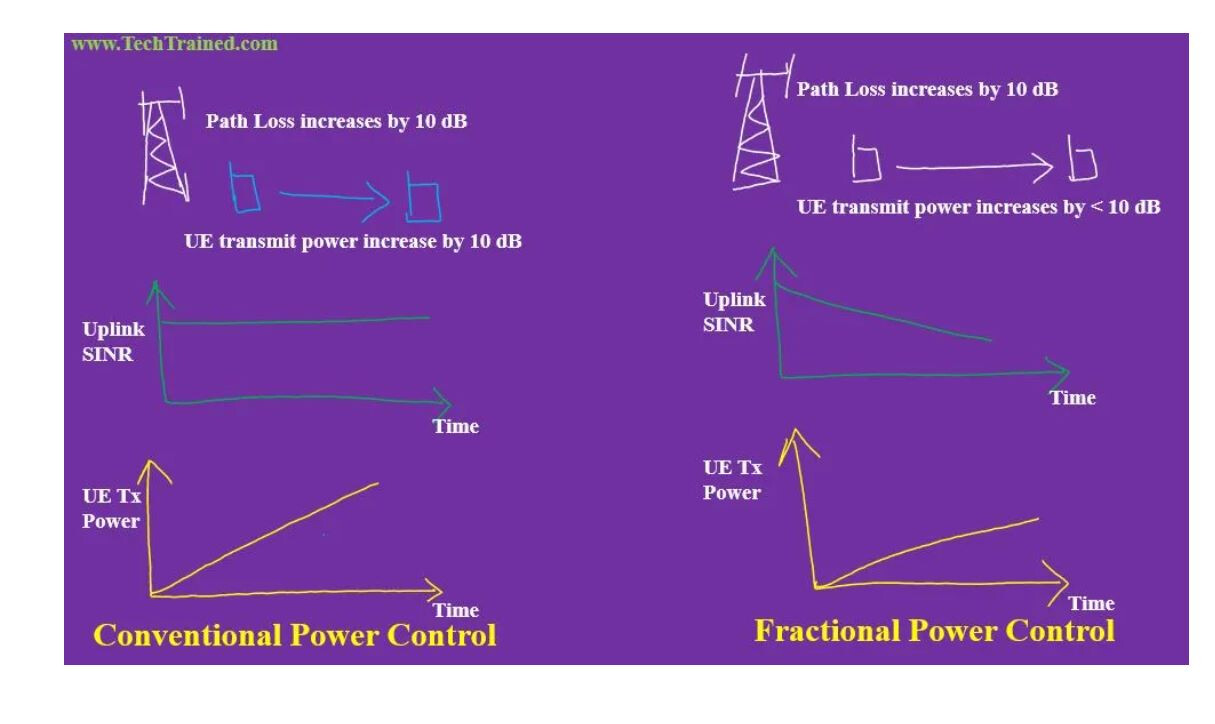

How to calculate the best values for p0NominalPusch and alpha for 4G?
It is expalined here: LTE Power Control (Case of Uplink Channel : PUSCH) – Tech Trained
You need to get used with fractional power control.
This picture is important:
Thank you very much!
