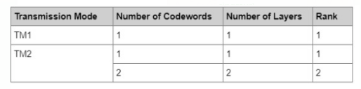

What is tm mode for 4x4 in UL?
2x2 UL MIMO:
In the UL there are two transmission mode TM1 and TM2, where TM1, was introduced in Release 8 and TM2 was introduced in Release 10. in UL 4x4 TM2 is used.

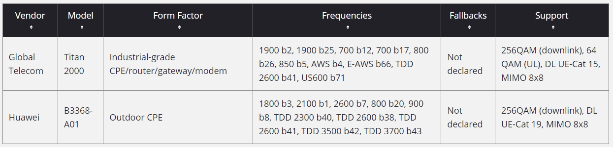

Actually, first i meant is there any UE or FDD modem that can receive 8 RX?
If I understand correctly for UE to report back rank 8 it must have 8 separate receive antennas?
8 antennas and 8 ports in the LTE chipset module. Or NR.
Yep, two devices. Check out GSA Gambod: 5G Device Database GAMBod | GSAcom
