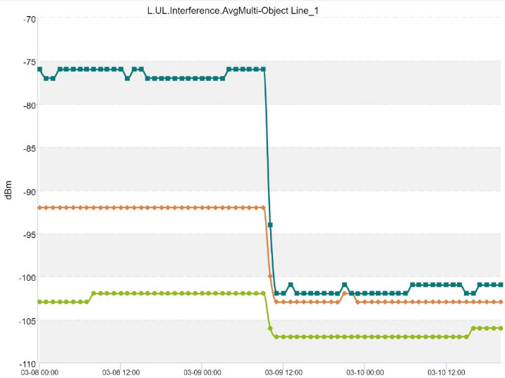

you can check UE Power step increase parameter. it can cause High UL Interference if you didnot set properly.
Hi folks - so I tried to (excessively) downtiling from 2 to 9 and here are the results of “L.UL.Interference.Avg”.
So with this it’s definitely an external interference, right?
For me it is.
From my limited knowledge it is, but monitor it on a daily basis before we can conclude that is external.
Thanks @javiersapon, @Vic20 both for the feedback.

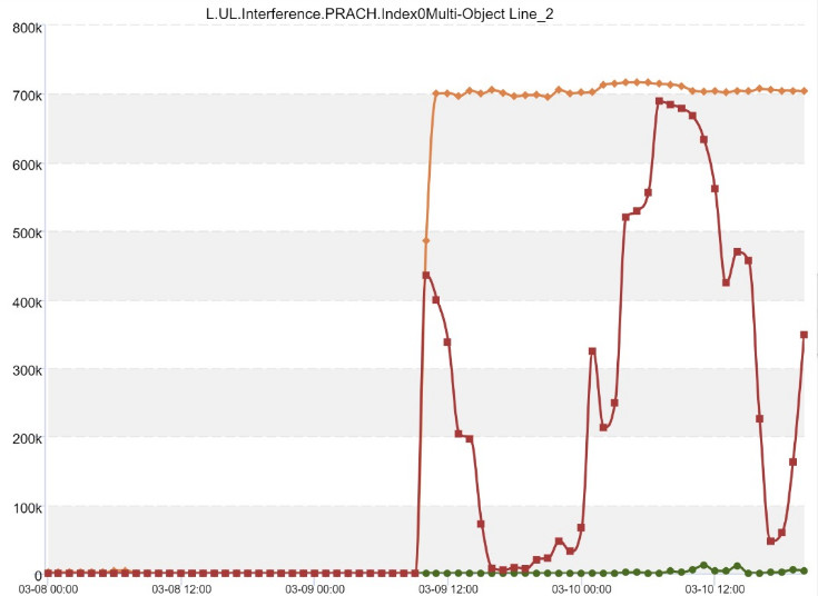

One thing I notice is the sudden rise of L.UL.Interference.PRACH.Index0 following the downtilting action.
Any thoughts on this?
You must have RSI conflict.
Check the RSI of neighbors cells.
Thanks @Maverick!
Some nbr cells have RSIs that don’t correspond to cell radius.
Do you think this could be the cause?
Also are you aware of any tools that could help audit/correct RSIs other than U-Net, Planet, etc?
