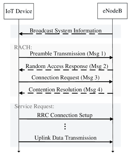

UE using Contention Based RACH Preamble
Hello,
Contention Based RACH Preamble using for;
  1. RRC Connection Setup
  2. Uplink Data Transmission
NonContentionBased RACH using for;
  1. Handover Process
  2. Downlink Data Transmission
So, it means Connected UE can 3 type of activities with PRACH:
  1. Uplink Data Transmission: If it wants to transport data on uplink way. It should to do ContentionBased R.A process.
