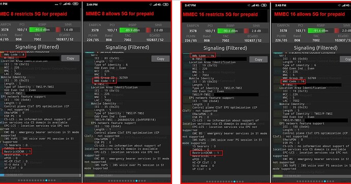

This restrict DCNR comes in attach accept and it is due to SIM not provisioned for NR.
Sometime you can overtake this restrict DCNR=true by forcing UE to 3G and then forcing it to 5G.
Here are the steps how to do it:
- 4G attach in any MME
- put the phone in 3G: Preferred Network Type : Prefer 3G
- change Preferred Network Type : Prefer 5G. (Most likely the MME takes the profile from 3G SGSN and it doesn’t get any 5G restriction from there since the SGSN doesn’t know what 5G is. The 5G restriction is set in HSS.)
- Enjoy 5G.
If it doesn’t work from the 1st time, repeat steps 2 and 3.

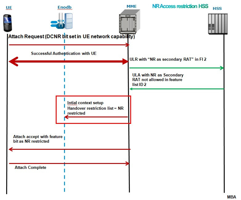

More details about restrict DCNR=1 here:
Ok. Spec says this.
If the RestrictDCNR bit is set to “Use of dual connectivity with NR is restricted” in the EPS network feature support IE of the Attach Accept/Tracking Area Update Accept message, the UE provides the indication that dual connectivity with NR is restricted to the upper layers.
With the above methode (force to 3G then force to 5G) people get access to 5G VDF romania without any special needs.
Otherwise it needs special subscription at VDF.
This trick works with Huawei EPC Core.
Don’t know for other vendors what will happen.
All the screenshots are taken with NSguru.
Fantastic UE monitoring tool that allows saving DT logs directly in the phone for 2G/3G/4G/5G in dlf format (Qualcomm) or csv format.

Actually in our lab we are seeing though UE receives DC with NR as restricted in attach accept.
It is able to measure NR and add NR cell.
So a bit confused…
Which UE please?
Mediatek, Samsung.
Please make sure you are looking at right message.
There are 2 of them.
:attachh request:n The message carries the NAS Attach Request.
The DCNR bit in the “UE Network Capability” IE is set.
This signals to the 4G Core Network that the UE supports dual connectivity with 4G-LTE and 5G-NR.
The answer is in the attach accept where restrictDCNR is either present (meaning no 5G NSA possible for this UE and this SIM card) or it missing (meaning5g NSA possible).
So again where are you looking at DCNR?
Attach request or attach accept?
Im looking at attach accept.
If the build in the UE is old, I see not all 3gpp stuff are strictly followed.
So this might be one of the case.
Do make sure you have the latest build.
Yes, that can happen in old UE build.
I have also seen this behaviour with certain IE.
And the behaviour was corrected in the newer versions.
