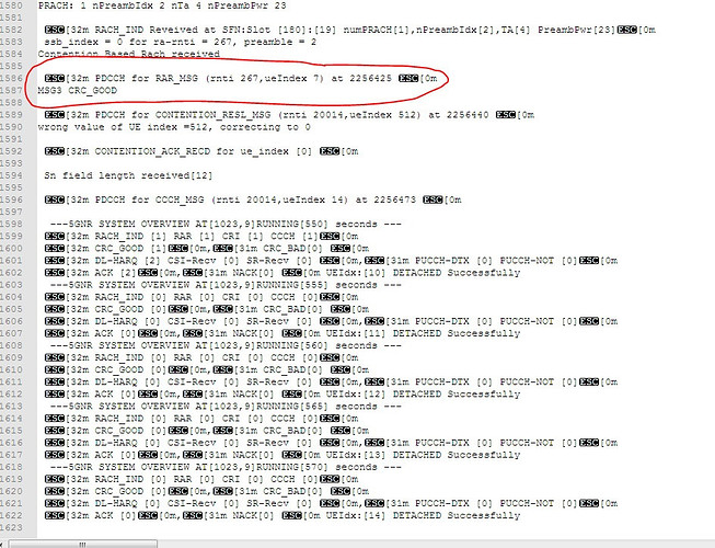

Actually you only see MSG3 good crc in UE logs
Then you see:
e[32m PDCCH for RAR_MSG (rnti 267,ueIndex 7) at 2256425 e[0m
MSG3 CRC_GOOD
e[32m PDCCH for CONTENTION_RESL_MSG (rnti 20014,ueIndex 512) at 2256440 e[0m
wrong value of UE index =512, correcting to 0
So MSG4 cannot be transmitted due to wrong UE index.
So try making another reset to gNodeB and clear all alarms major and critical.
Your gNodeB fails in transmitting msg4.
I understand. Are you sure can’t I see msg4 because gNodeB fails in transmitting msg4, and the problem of course UE index?
And just by reset I could solve the problem?
Do something until you won’t see this anymore “wrong value of UE index =512, correcting to 0”.
Should be 7 not 0.

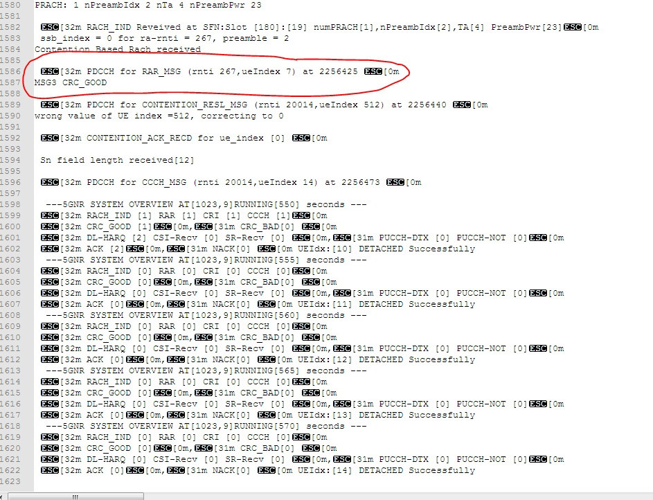

But I have as u see in the log the ack of msg4.
It’s [32m CONTENTION_ACK_RECD for ue_index [0] [0m
So there is transmission and ack for msg4.
I am looking at bottom of the log.
You need ueindex=7 no ueindex=0.
This is your UE: index7.
So you need this: [32m CONTENTION_ACK_RECD for ue_index [7] which is missing in your log.
