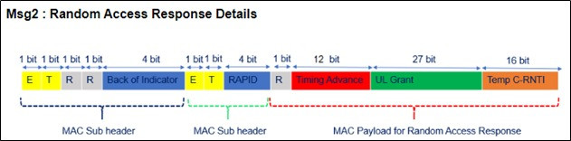

I think you have msg3 but with bad CRC on PUSCH.
Can you please paste here the content of msg2 like in this picture:
Also the content of msg3 as sent by UE?
Also check what’s the number of harq retransmissions for msg3: maxHarqMsg3Tx
