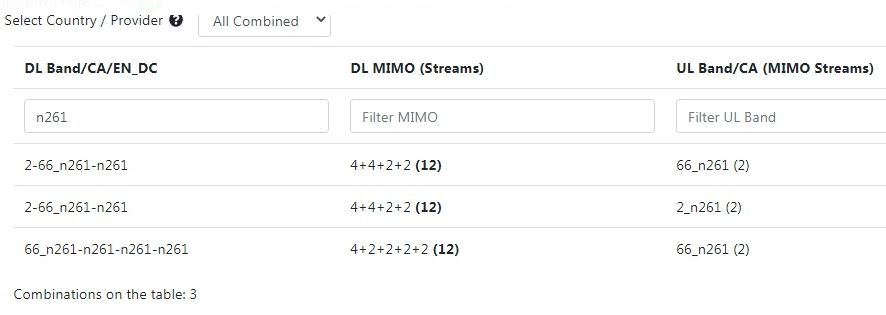

No mine is n78.
Could you let us know full name of your 5G phone?

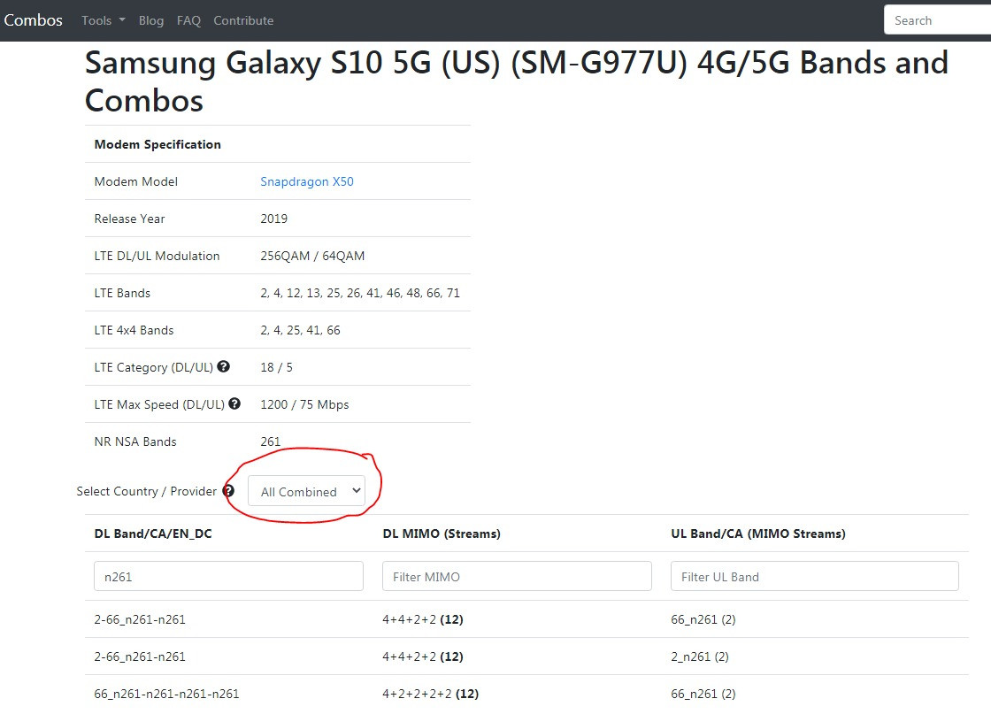

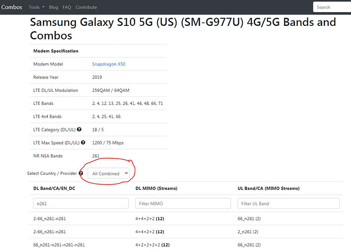

Samsung Galaxy s10 5G smg977u.
n78 should be there, no MNOs kick it out, as it is global.

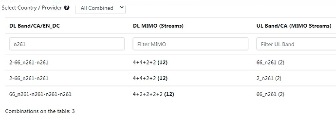

Here is CA combination for n261:
But your phone is not listed with n78 support.
And it says “all band” that means unrestricted CA combinations.
In this case it is impossible to have n78.
Look no longer than this.
I think this is the answer to your question: UE does not support n78!

So is this restriction not due to chipset right.
This site is based on UE cap msgs.
