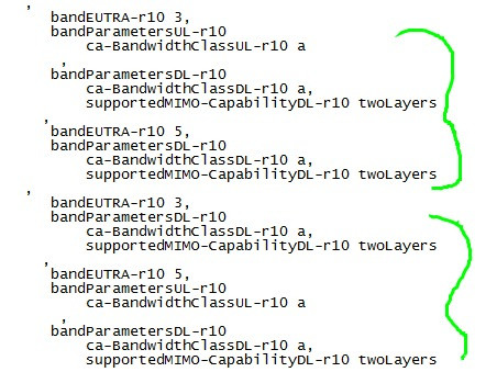

Have you ever seen in UE capability that both 3A_5A and 5A_3A are mentioned?
I see like band 3-41 and 41-3.
What is difference between these 2?
Like in 1st band 3 is PCell and in 2nd band 41 is pCell?
Yes, correct.
B41 is TDD and B3 is FDD.
So B41-TDD PCell and B3 -FDDas SCell can never happen as it is not supported band combination.

1st one is B3 is PCell and 2nd is B5 is Pcell.
SO it mean UE support both. Even though 3GPP metntion only 3A_5A
