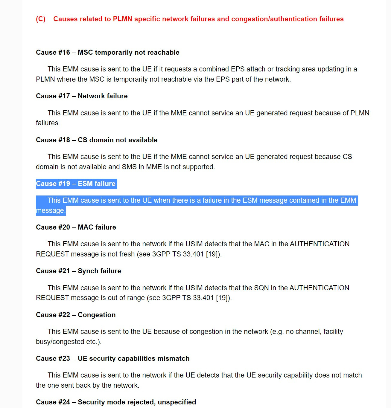

ESM fail cause code 19 (S1 trace).
TAC is OK.
Try with another UE and another SIM:

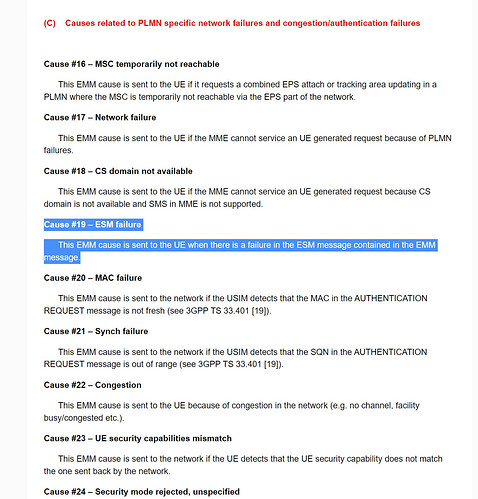

Cause #19 – ESM failure
This EMM cause is sent to the UE when there is a failure in the ESM message contained in the EMM message.
